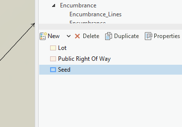

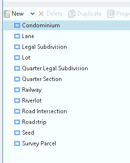

However, I noticed afterwards that the template symbology for all the symbology classes has changed to the symbology for seeds.

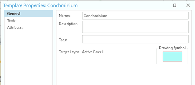

Interestingly, when I look at the Template Properties for each of the symbology classes, I can still see the Drawing Symbol that should be in the template.

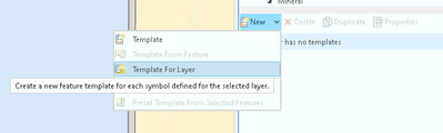

I also tried selecting all the template symbols, deleting them, then using the "Template For Layer" tool to re-create the templates.

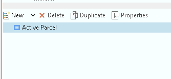

However, that resulted in only 1 template being created for the whole layer, still with the Seed symbology.

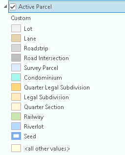

Do you know how to get the template symbology to match what is showing in the Contents pane? Thanks very much.
