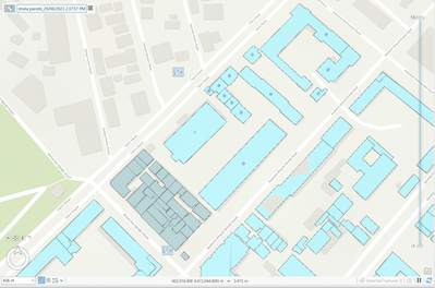

But when I check the Floors don't appear to overlap.
How exactly do I create Strata Parcels?
The Strata Parcels I made look like Photo_1.
  • Photo_1
JasonCamerano
Make sure that you've added the Floor Order field (type LONG) to both Lines and Polys of a specific parcel type.  Then when you duplicate the parcels for different floors set the Floor Order field as the field to be incremented.  Then you should be able to see the parcels for each floor value.

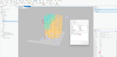

Hi Jason, firstly thank you for posting this 2Tutorial. I'm running into trouble when I try and replicate the extrusions though. I am copying the code as per the video example, but my extrusions always seem to begin at the second floor. Additionally, the first 3 floors are extruded at the height I set (3m), but then the top two floors appear to be double that. It also groups the floor levels together in a strange way, i.e., my floororder 5 when selected is the top two floors (blue shading), but it should just be the uppermost floor. I've attached a screenshot, but any advice would be appreciated. Thank you
JasonCamerano
Based on the graphic if that floor unit you have selected is floor 5 that means the "first floor" that you duplicated from are all Floor 0 and I'm guess the expression doesn't show because it's doing some sort of multiplication by 0.  You might want to select all those first floor units and set them equal to 1, then run the duplicate parcel on those.  As for the extrusion, in that expression you have you're multiplying the Floor by a value which would give you a larger number for each floor.  You can just return a solid number like 5 and then each floor will be extruded by 5 (meters or feet or whatever unit you use).
