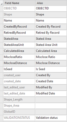

Parcels
These are the new system fields in Pro. They always appear on the top and you cannot delete them:

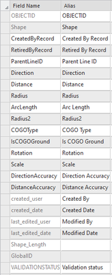

Parcel Lines (and connection lines)
New system fields:

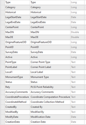

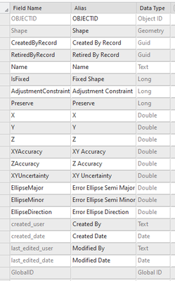

Points
New system fields
Old ArcMap Fields - consider deleting the fields that were never used. Some fields such as Category, CenterPoints should be deleted. If you ever maintained the point accuracy using the MaxDN and MaxDE fields you can move translate these to the XYAccuracy new field.

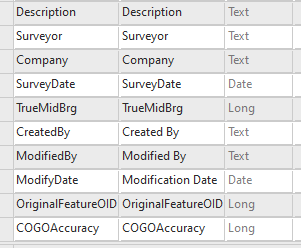

Records
ArcMap 'Plan' fields
These are the old ArcMap 'Plan' fields, most customers never maintained the surveyor name, company and SurveyDate. If you did you can keep them and continue to do so. COGO accuracy is now maintained on the lines and points that are created by the record (plan).
TruMidBrg (True Mid Bearing) can be deleted and/or moved first to the new 'direction type' field. This is only used by federal agencies that maintain old PLSS or fake modern GNSS measurements to look like old theodolite observations.
