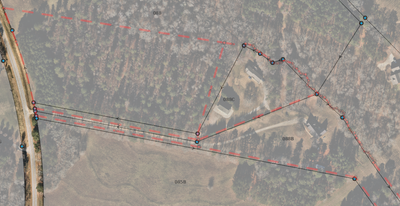

I got an updated survey in and it is substantially different from the original record. The original line was just a simplified version of the stream that forms the boundary. The new survey actually follows the curve of the stream. What is the best way to align something like this?
Here is a screenshot of the area. The red line is the new boundary and the black line is the current line that needs to be replaced.

I may be misunderstanding what you mean, but I don't think I can merge, because no parcels are being combined. Here is an overlay that shows what needs to happen. The red lines are the new geometry (which will result in one additional parcel being created.
