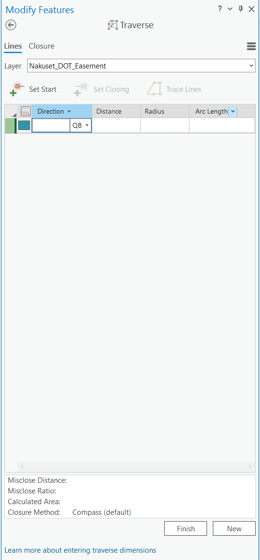

Those sound like delta angles. On the Traverse tool, click the dropdown at Arc Length and change that to Delta Angle and enter the angles they give. I would assume the curves to be tangent to the preceding segment, too, meaning you can leave the bearing the same.
