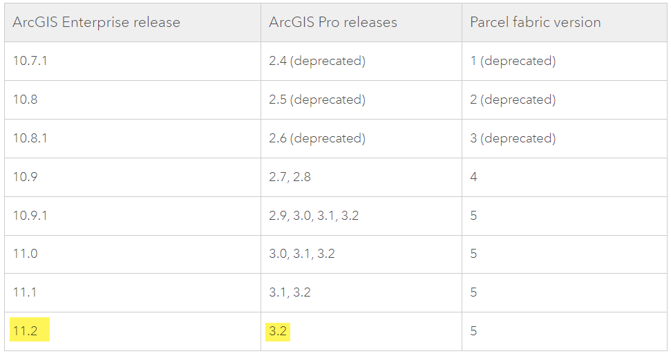

You can find the parcel fabric compatibility table here: https://pro.arcgis.com/en/pro-app/latest/help/data/parcel-editing/parcelfabricversions.htm
The rule of thumb is that the ArcGIS Pro client must be the same or newer than the corresponding ArcGIS Enterprise version.

Update: after trying every possible (I thought) combination of clicks, restarts, etc., I installed ArcGIS Pro version 3.2 and am able to edit.

@AmirBar-Maor Hello - I wrote that we have published our data to Enterprise Portal 11.2. I didn't see in any documentation that ArcGIS Pro version 3.2 is required, but that is what eventually allowed me to edit again.
