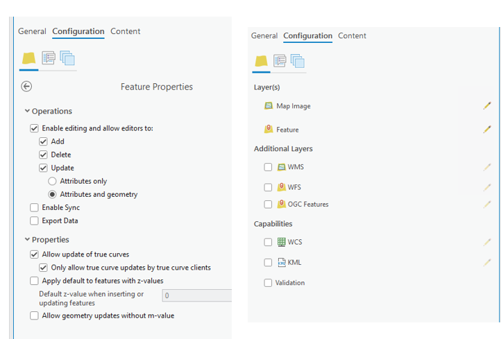

This is how are arranged
these are the layers how i am publishing them. my user has assigned a parcel fabric license, I have a ArcGIs Enterprise 11.1, ArcGIS Pro 3.1.4, SQL Server 2019
What can be happening? I have done several services before and I was able to do it but now, those options for publishing does not appear. Any Idea

I can see from your screenshots that Version Management is missing under Capabilities and Include topology layer is missing under Feature Properties.

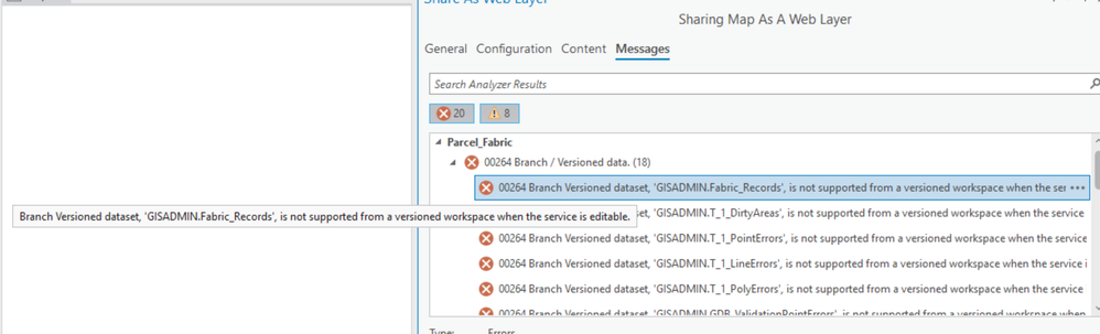

The best thing to do at this point is to run the analyzer. It will of course tell you that Branch Versioning is not set, but it should give clues as to why.
Some things to check when the Branch Versioning option is missing:
1. Make sure the fabric feature dataset was registered as versioned.
2. Is the geodatabase connection file set to Branch?
  • Right click the .sde file and choose Geodatabase Connection Properties
  • There should be an option for Branch versioning
  • If this was the issue, check the option on and re-add your fabric to the map
3. The Validation or other layers and tables were not registered as versioned.
  • Perhaps the parcel fabric is registered correctly but something else isn't.
  • This could be the 3 validation layers and its associated table.
  • Some other supporting layer that is outside of the feature dataset.
Run the analyzer and let us know what it reports.  Thanks!

Yes it gives me this version error for all my layers, besides dataset i have 3 objects layers and one table, and all of them are set to branch version.

Ah, OK. According to the error, the feature classes are registered as versioned but the connection file is not set to Branch.
00264: Branch versioned dataset, <value>, is not supported from a versioned workspace when the servi...
  • There should be an option for Branch versioning. Select Branch
  • Re-add the fabric to the map
