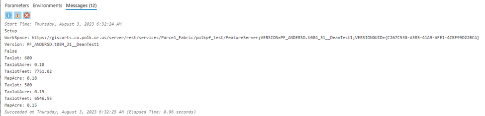

  • Am I referencing the versioned workspace incorrectly? (I display the version and workspace  as part of the script messages)

Below are my messages referencing the version and versioned workspace...
I would VERY much appreciate ANY Help.  Thanks
