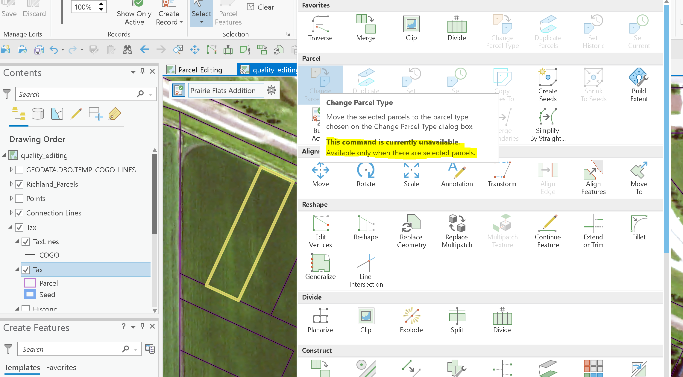

I am having an issue where newly created parcels are apparently not recognized as parcels.  The parcels were created by: 1)using the traverse tool to create tax parcel lines, 2) creating seeds and 3) building active record.  Now I want to change parcel type to "pending parcel" and the tool icon is grayed out with an error message shown below.
You can also see that there are multiple tools grayed out that should be available.

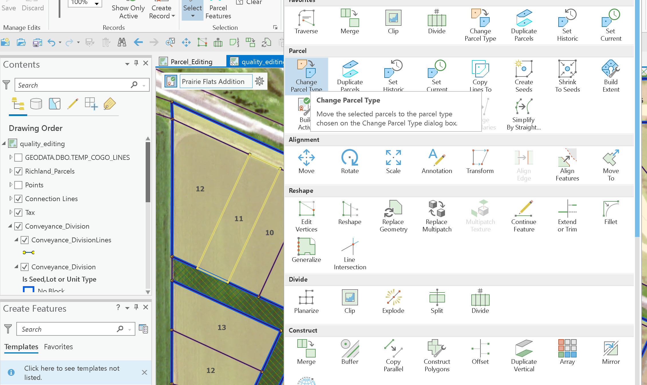

Below is what happens when I try to do exactly the same thing, but using a Conveyance Division instead of a Tax parcel.  (Same workflow under the same record)

This is weird and not the expected behavior.
Could you try to add your parcel fabric to a new map? If it works there for Tax parcels it would indicate that this might be a map configuration issue. If it works in the new map, you can try to copy-paste the tax layer from the temporary map to your editing map.

Good call.  I put the fabric in a new map and the tools are available when selecting a tax parcel.  A real pain to reconfigure how I want it, but at least doable.  Thanks.
