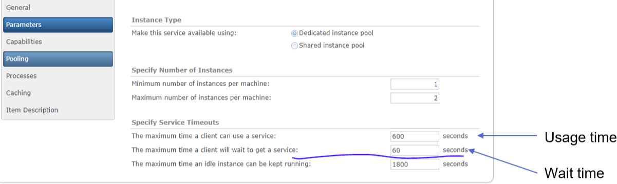

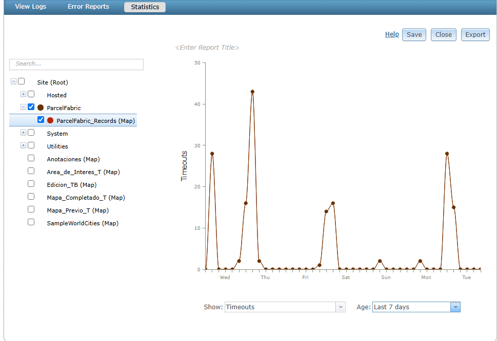

I am having some issues with parcel Fabric Service. I have not been able to understand why the parcel fabric service generate a lot of time out. We notice a degradation of the service performance at afternoon, it start getting unresponsive and take several minutes to response for an action. ( we checked with IT and there is no process running at afternoon that could affect performance)
We were having also some error on the server manager
  • Error performing query operation Wait time of the request to the service ‘Parcel Fabric/ParcelFabric_Records.MapServer’ has expired.
  • Processing request took longer than the usage timeout for service 'ParcelFabric/ParcelFabric_Records.MapServer'. Server request timed out. Check that the usage timeout is appropriately configured for such requests.wait time.png
So, we checked this information
https://enterprise.arcgis.com/en/server/latest/publish-services/windows/tuning-and-configuring-servi... and modify usage time from 10 minutes to 1 hour, because that is the time people use the service approximately, and wait time from 1 minute to 5 minutes. But we had a even worst behavior.
My question, what would be the recommendation for max time a client can use a service and maximum time a client will wait? any suggestion? also we have not seen any issue with CPU or memory on the VM's so we can say it is not because system requirements.

Geographic_Mythos
Looking at your screenshots, it may be possible you do not have enough dedicated instances (SOCs) for your fabric services.
From my experience with our Fabric, that low of a SOC count would be the first thing I would try adjusting if your server has room to do so.
Things you may want to think about that could be affecting your behavior in the afternoon: users reconcile/post process (these can queue SOCs quickly, and if you only have two, you may be 'waiting' while that process completes), large numbers of user requests querying fabric information (again, this can queue the SOCs so that they are waiting to complete other requests), or other applications making requests to the Fabric service, just to name a few.

DiegoLlamas
Hello Benito,
we had an issue with database (Microsoft SQL Server) and DBA create the database separating everything in its own partition, data, Logs, temp logs, backups, ETC.  And as @Geographic_Mythos mention, we add socks and time for wait time from 10 minutes to an hour. Also change heap size for server and parcel service to 256 and 128 and now, he are getting a better performance after Esri Recommended to change the recycle the configuration of the parcel fabric service every 12 hours instead every 24 hours, Now we see a more stable service and a better performance, we still see wait time, once a day,, instead of several times. Now users are able to work.
Hedstrom_Jeff
@DiegoLlamasOlivares I would definitely suggest experimenting the min/max instances per machine settings. We have only 2-3 users editing our parcel fabric and we have that number set at 10 & 10. 1 & 2 is likely way too low even if it was just a single user editing the versioned feature service. Try that and open up the Diagnostic Monitor pane in Pro and see if you have any more time outs or stalls occurring. I believe we have also had to tweak with the dedicated resources on the VM, in terms of putting more CPU and RAM on that server.
