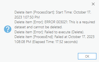

Original Local Government Model, Parcel Fabric, includes Feature Classes (PLSS_Quarter_Section, PLSS_Quarter_Section_Lines, Conveyance_Division, and Conveyance_Division_Lines) that don't fit into our right-of-way parcel types. When trying to delete those Feature Classes, the outcome is a message:
I have a second Parcel Fabric, Local Government Model also, that has none of the four listed Feature Classes. So, I am not buying the "required dataset" message. Any ideas?

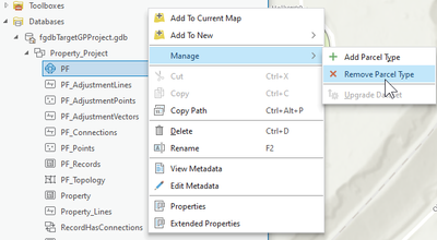

Mark,
I see messages similar to this when trying to delete a feature class if I have forgotten to first remove the parcel type from the fabric. You should be able to delete those feature classes. To remove the parcel type, right click on the fabric in the Catalog pane, and click Manage->Remove Parcel type, then in the GP tool that's presented, enter the name of the parcel type to be removed. You'd repeat this for each parcel type.
After removing the parcel type, the feature classes should be "released" from their controller, and you can try the delete again.

Yes. I followed Tim Hodson's directions and was subsequently able to delete the Feature Classes.
