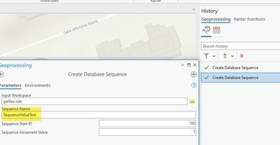

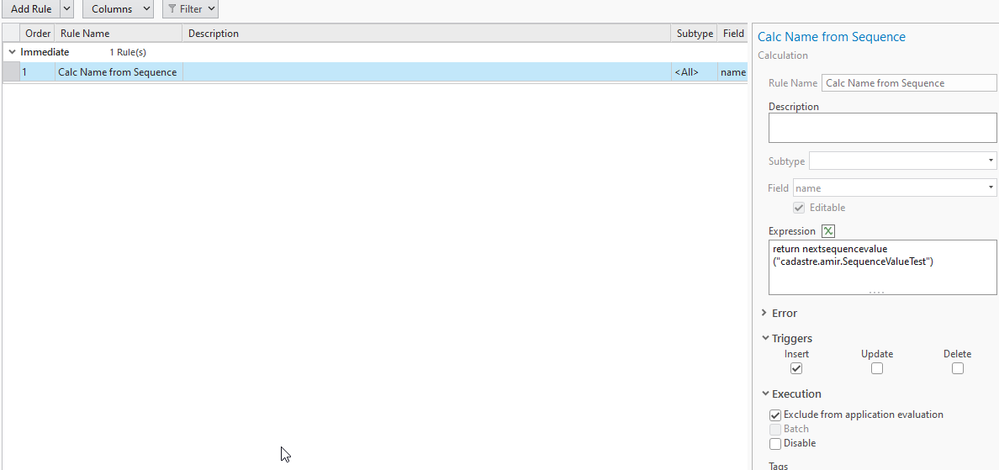

I am using ArcGIS Pro 3.0 against a 10.9.1 Enterprise and the rule works for me. The only difference might be that I did not check the 'Batch' option since I want the name field to be calculated as the feature is created. You you mark the batch option it means you can defer when the rule is being executed and need to use the error inspector or the Evaluate Rules geoprocessing tool.
The one 'gotcha' I've noticed is that after creating the sequence in the geodatbase I could not find it and had to use the geoprocessing history to make sure I have the correct sequence name.

I've created a new batch rule and it is working.

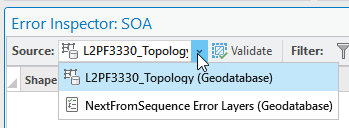

I think the reason it is failing is because you might not have the error layers in your map.
Here are a few steps:
1.  Before publishing the map make sure to add the error layer to it
2. Once you have published your map and added the parcel fabric to a new map, right click on the parcel layer and add the error layers to the map.
3. Open Error Inspector and switch from the parcel fabric controlled topology to the Attribute Rules
4. You can check the Batch Calculation and evaluate the rules. It worked for me.

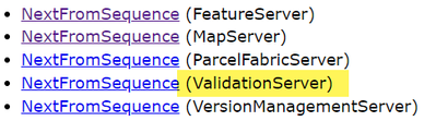

Assuming you checked the Validation capability when you published, you should be able to see the validation REST API exposed on your server:

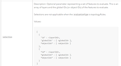

The first thing I did was to verify that the Evaluation service REST API supports a selection set.
It does 🙂

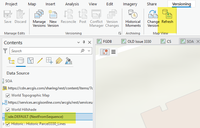

To see the update (another 'gotcha'), you will have to select the version in the contents pane \ data source tab and then hit refresh. I have verified that only the selected features are updated.
