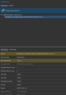

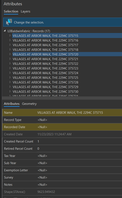

I am having to do some migration clean up with some of the records that were generated when we migrated back in December. There are roughly 70,234 records that are tied to various subdivisions that need to be consolidated based on the subdivision name. Is there a way to easily do this instead of one sub at a time? I have tried to narrow everything down by definition queries, removing pin numbers, etc. but I get locked up or the data disappears. I also would like to be able to mass updated the record type.
Here is an example of two separate sub records:
Current (Not merged)
End result (Merged)

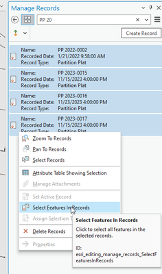

  3. Open Manage Records and search for the records that have the features you want to move over to the newly created one
  4. In the manage records pane select all the records and then right click and choose Select Features in Records (use shift click to multi select)
  5. Now all the polygons, lines and points from all those records will be selected.

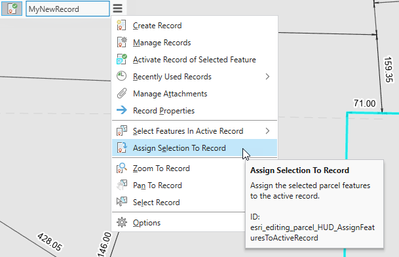

  6. Go to the records HUD and click the menu button and choose "Assign Selection To Record"
  7. Those features will now all be assigned to your newly created record.
  8. You can now clean up those empty records by deleting them as necessary.
Let me know if this workflow accomplishes what you need.
