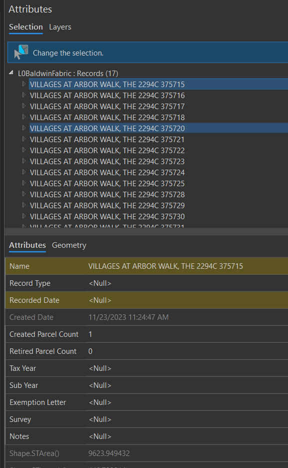

I am having to do some migration clean up with some of the records that were generated when we migrated back in December. There are roughly 70,234 records that are tied to various subdivisions that need to be consolidated based on the subdivision name. Is there a way to easily do this instead of one sub at a time? I have tried to narrow everything down by definition queries, removing pin numbers, etc. but I get locked up or the data disappears. I also would like to be able to mass updated the record type.
Here is an example of two separate sub records:
Current (Not merged)

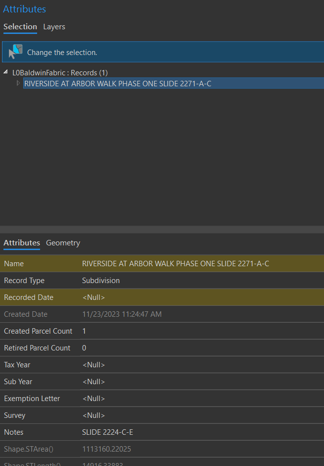

End result (Merged)
