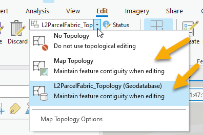

I would verify that either Map Topology or GDB Topology are active on the Edit tab

Whether or not there is a topology rule does not really matter for your specific scenario, but as Jason  mentions, you do need to specify either Map topology or the fabric's gdb topology in the edit tab, to enable topological editing.
