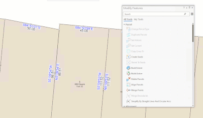

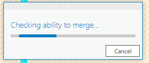

In my case 2.8 I can see Check ability to merge running for a long time.
Dennis gave me the idea to Cancel the window and choose my point, in order to improve the performance.
The smart choice in my case and I can see it in your case also is to select the point with lowest objectid as default.  you might consider choosing the point with the highest objectid as default because usually is coming from a newer survey and not from one where a surveyor who used a compass and a chain.
