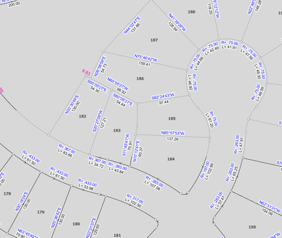

One of those just now is that the map frame fails to completely load the data visually even though features are loaded into the application - because they're labeled and selectable.  Observe a sector of conveyance divisions and see that the lines have not drawn.  However, their labels are still displayed:
Incomplete drawingIncomplete drawing

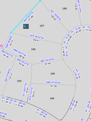

When I click on the west boundary line of lot 187, it is indeed selected and loaded into the attributes window:
Selected featureSelected feature

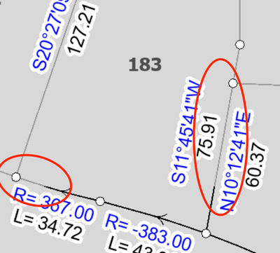

Max records returned is currently set to 2000.  I don't suspect that's an issue, as it appears to be a rendering problem - see how only half the line is drawn in the circled areas:

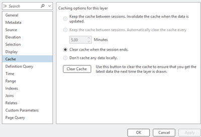

If the missing feature eventually draw, it might be a caching issue. Have you tried clearing layer cache on affected layers? You might also try "Don't cache any data locally".
