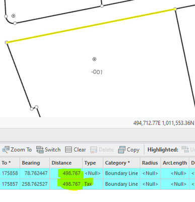

I've run the Upgrade ArcMap Parcel Fabric GP tool with the option to delete identical overlapping lines checked.  I read that identical overlapping lines will be deleted even if the directions are reversed by 180 degrees, and if the Distances in the Distance field are the same out to four decimal places.
 The Distances in the Distance field is where I'm seeing the possible problem.  A lot of my lines are essentially the exact same but differ in distance at the fourth decimal place.  So, I believe this is why they're not being deleted.  Some duplicate lines are being deleted and come into the Pro fabric as a single line because the lines in the ArcMap Fabric are the same out to the fourth decimal place.

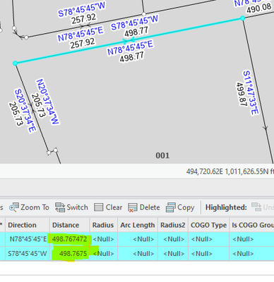

With that being said looking at the Direction Field, rounding to 6 decimal places the values still differed between the two lines.  Use these lines as an example
You can see on the left the UpgradeDirectionMinus180 fields differ between the two lines.  And the Direction values that are stored have huge precision.  Seeing this makes me think that these full raw values aren't necessarily important to you so running Delete Identical simply against the shape of the line features might be a viable option for you.

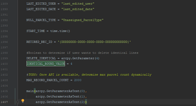

4. Once the file is open scroll all the way to the bottom and you will find a variable called IDENTICAL_ROUND_VALUE.  It is currently set to 4.  Change the 4 to what ever rounding value you decide
5.  Save you changes and close the editor
6. Copy and paste the .py file back to the original directory in step one and overwrite the existing file.

 I've followed the steps you outlined and modified the script so the variable, IDENTICAL_ROUND_VALUE = 3.
However, I'm still getting the same results, the resulting Pro Fabric still has the same duplicated lines.  So, it looks as though the modification to the script is not being honored.  Could this be a potential Bug?  Any other suggestions, or would you recommend running the Delete Identical on the Shape_Length field?
