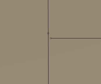

I have a subdivision I just created, but realized the lines came very close, but did not snap to each other. Is there a way to quickly select the subdivision lines and run a tool to make them all snap together (with a certain tolerance)?
My solution for the moment is to go through each one and use the extend tool on them, but that's pretty tedious.
Here I'm zoomed in to 1:0.04 and you can see the lines are not actually connected:
