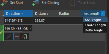

Did you try the "delta angle" option?
Entering the delta angle and the radius yields a curve with the correct arc length.

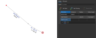

Even though the Traverse is typed up with tangent bearings, it inserts the chord bearing into the COGO attributes. You can see that the calculated chord bearing based on the delta angle matches what you calculated.
Outside of the traverse, I was able to confirm that using the Circular Arc tool does present the same option of delta angles. So either way you come at it, you can easily enter the information given on the plat and get correct, accurate COGO lines. No magic required, just using the appropriate tools.

I just hate when they do that! I've got whole subdivisions I can't fully draw up because I don't have enough information about some of the curves, and they have no tangent segments to start from.
In this case, however, they are giving you the delta angle, and i think it's fairly safe to assume that the curves are tangent to the S49-39-46E segment. If you're using the Pro Traverse, you can actually specify delta angle as an input when chord bearings are unavailable. The "circular arc" tool may also have this option, though I don't have Pro open right now to check.
