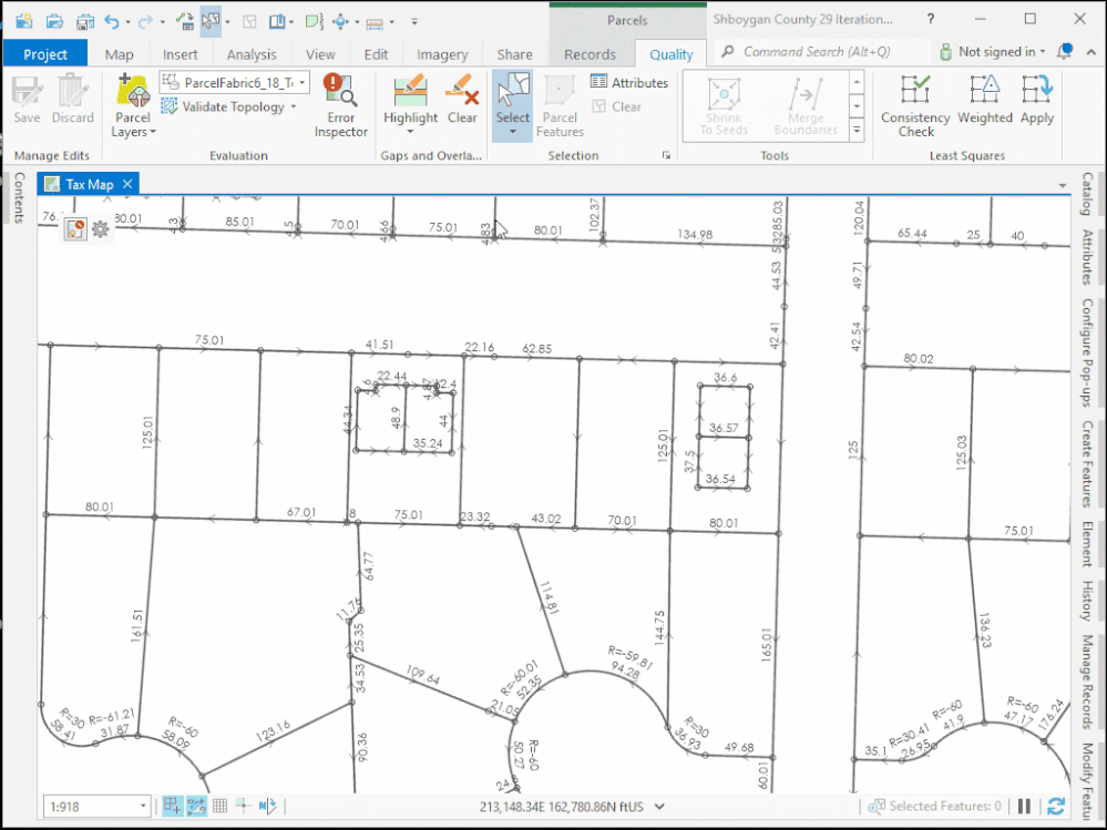

Here is how the Highlight Gaps and Overlaps tool looks like.

We recommend removing the CURRENT MUST NOT OVERLAP rule and use the too Highlight Gaps and Overlaps instead for the following reasons:
  1. The new tool is more efficient
  2. The new tool is capable of detecting gaps
  3. The new tool accepts a tolerance, so you do not identify empty spaces like roads as a gap.
  4. Unlike validating topology, the new tool does not modify the data
