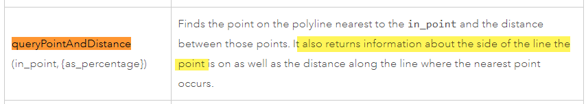

@RobertChaney
Great to see that you are improving efficiency by moving away from annotation to labels.
From looking around you can use the arcpy method ' queryPointAndDistance'
It is documented here:
https://pro.arcgis.com/en/pro-app/latest/arcpy/classes/polyline.htm
You can also view this code sample copy - pasted from  here:
pnt = [x[0] for x in arcpy.da.SearchCursor("point",["SHAPE@"])][0]
line = [x[0] for x in arcpy.da.SearchCursor("line",["SHAPE@"])][0]
line.queryPointAndDistance(pnt)
#output
(<PointGeometry object at 0x27b71d30[0x27b71860]>, 212.1234, 23.1234, False)
Another place to look at is this community post which concludes the use of the same method.
Once you have it working it might be good to share with others that run into the same issue and want to leverage the LabelPostion field.
