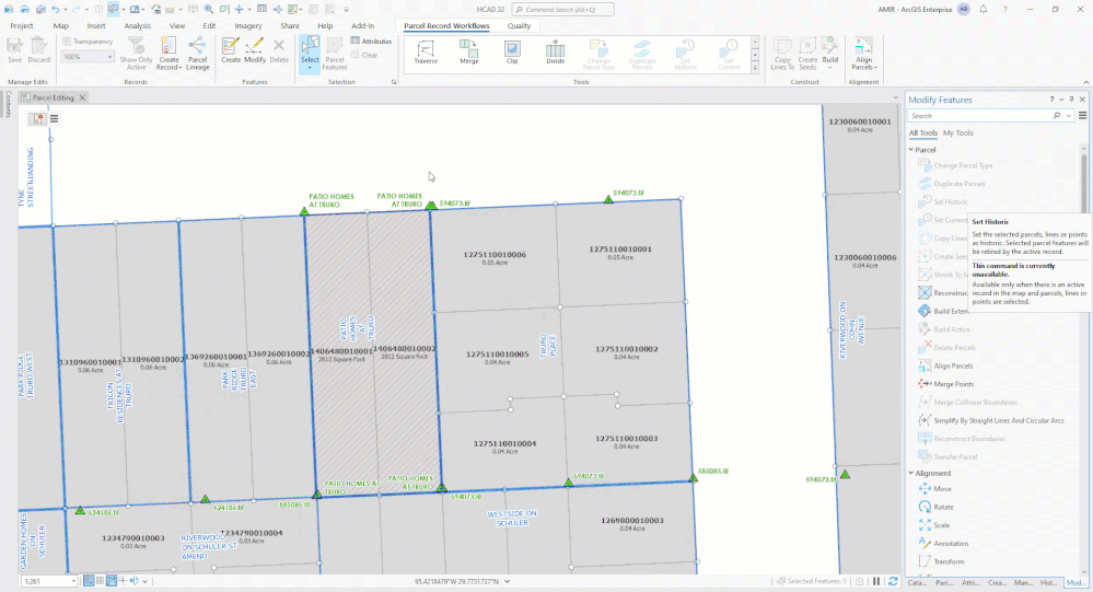

Need clarification on when you would edit in an existing parcel record verse creating a new parcel record.
As part of building my parcel fabric I will run the GP tool create parcel records, to create the initial records.  This field will usually be based on a unique parcel number or a subdivision name (if the parcels are within a subdivision boundary).
I've noticed that when I create a new record and split an existing parcel, the new record boundary has the same geometry as the record that was initially created for the parcel being split.  Is this what I'm suppose to see?  I was  thinking that that new record would be just the geometry of the new split parcel.
Does anyone else create initial records for their parcel fabric or create them as you go?
My screen shot shows the same record boundary for parcel 11.001 and the new record for parcel 11.002

The purpose of having a record is to know the source of a parcel, and to make the data in the 'system of record' defendable.
Using the parcel name to create a record for each parcel, does not make any sense to me. It would be better to create a record called 'unknown' or 'legacy data' or 'Digitized from paper maps 1995'... something that would make sense when you identify a parcel.
If you've already migrated the data and already started creating real records, you can still recover:
  1. Select all the parcels that were migrated (you can use 'Select by Attributes' and use the editor tracking fields).
  2. Use the geoprocessing Create Parcel Records' and use the expression option to enter the name of the record. For example 'Legacy data - source unknown', and run it.
  3. Open the attribute table of your records feature layer and make sure all the parcel based records are deleted (you can use the same method above to select them)
As for record geometry:
  1. Record geometry will only be created or updated when the number of parcels associated with the record is less than 2000. This is done for performance and you can change this setting in the parcel fabric properties.
  2. The record geometry is the union of the retired and created parcel geometries, as it is the footprint of the legal transactions and impacts both. For example: we have organizations that create a record to retire a lease - in that case they only retire parcels and do not create any new child parcels.
  3. Certain operations like Build, Merge, Clip, Divide, Split ... will update the record geometry when you have an Active Record. Alignment workflows do not do that but you can always use 'Build Extent' to trigger an update.
I hope this helps, and more importantly, makes sense.
