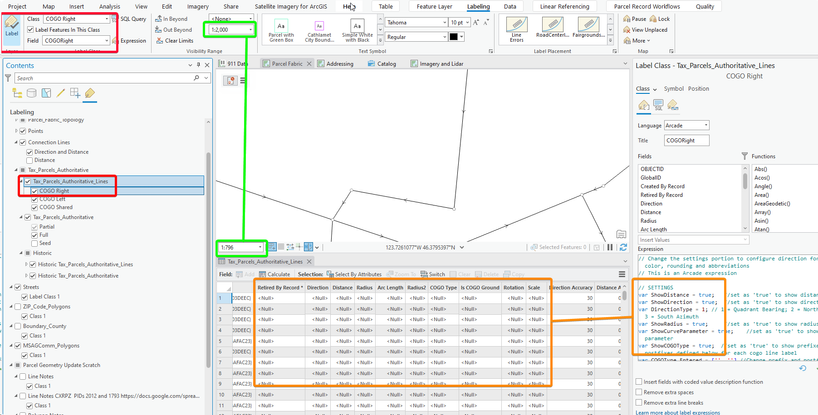

For my parcel lines, I would like to be able to see their out-of-the-box labels. Currently, they are not displaying. Do I have to populated the empty attribute fields in the lines layer (elevation, distance, radius, arc length, etc) to enable the labels to display? If so, what tool do I use to do that? Enable COGO tool? 😬

You can use the Update COGO tool to do this. The lines are already COGO enabled in the parcel fabric by default.
https://pro.arcgis.com/en/pro-app/latest/help/editing/update-cogo-attributes.htm

Thank you @ChristineLeslie 🤘 That worked first try no warm up.
