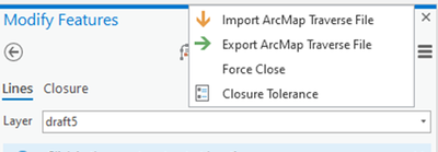

Thank you for asking this question, I am having this issue today and hoping the feedback on this page will help.  I am stumbling through it!  It has helped me to export the traverse (see image below) and import back in at a later time if I need.

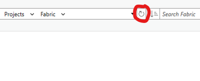

Has anyone had issues loading a traverse file exported from Pro.  I created and exported a traverse, can see the TXT file in Windows Explorer, but am unable to locate it in Pro.

Pro is notorious for needing the file system "refreshed" you most likely need to click the refresh button on the dialog to load your traverse.
