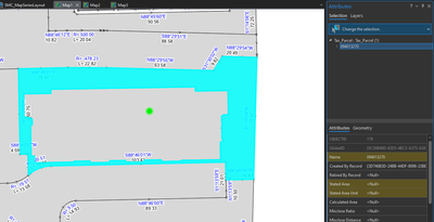

Hello,
I'm investigating on behalf of a colleague who is struggling to take a new parcel polygon that is completely inscribed within a larger polygon and clip to create child parcels.  In the below screenshot, the small, rectangular parcel is a new parcel, designated as the input feature, whereas the larger parcel is the target feature to succomb to the clip and result in a parcel with a 'donut' hole in it to clear the way for the rectangular parcel.
Is there possibly a limitation to the parcel editing clip in records-based transactions?  Because the current workaround is to deactivate the record, this is the only way to have the clip run through, but the concern is obviously the transaction will not output a historic parcel.
Thanks

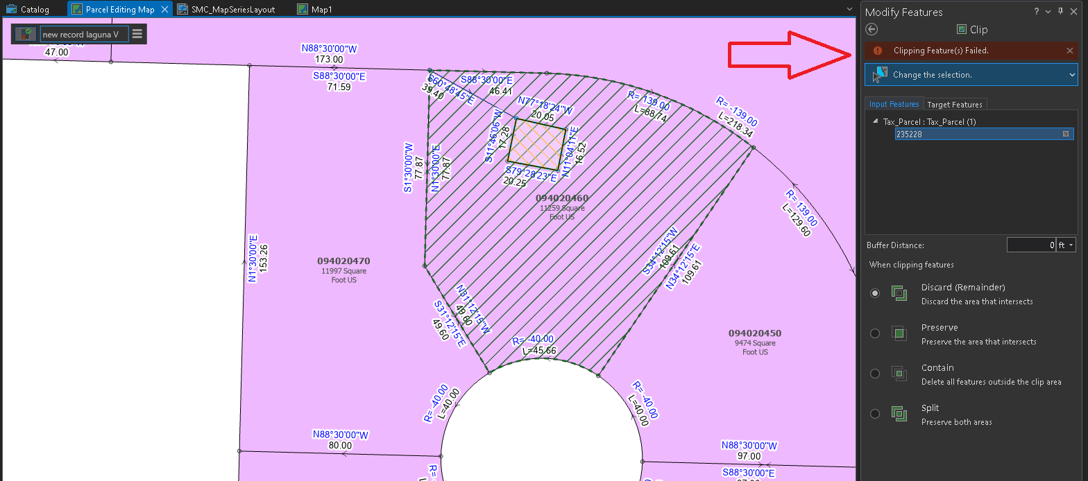

Thanks Dan,
Not sure why it's not working on our end.  I'm using 3.0 and the screenshot I shared earlier was my own independent attempt do run a clip with a remainder, which was unsuccessful.
A colleague of ours is attempting this using a polyline that represents a building footprint that was copied to parcel fabric COGO lines to build a new polygon (no connection line utilized).  This is their typical workflow in beginning to pave the way for condominium parcels.  They are probably using 2.9 still, as they are a large organization who hasn't collectively decided it is comfortable.
I could have sworn I was able to create a donut hole within an active record in the past, but just not today.  Not really sure what is preventing this. You don't suppose it's the dated version, do you?
