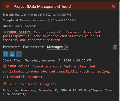

Neither parcel fabric will reproject. Identical error message for both, see below. Both databases passed topology checks.

Is this an ArcMap Parcel Fabric you are trying to project? If yes: this is not supported.

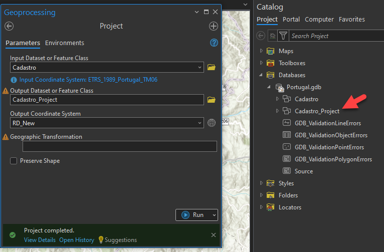

Please make sure to provide the FEATURE DATASET as input and not the parcel fabric data controller.
If this is a feature dataset that contains an ArcGIS Pro parcel fabric it should work. If it doesn't;t work with your data please contact technical support.
In this example, I've used ArcGIS Pro 3.3 and accepted the defaults. Make sure to select the
