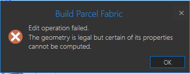

I have managed to mangle something in my parcel fabric, which generates an error that I really don't understand. I wonder if anybody has seen this before and perhaps could direct me to the right place for more information. The usual searches turn up nothing.
When I attempt to build the parcel fabric (either by extent or by active record):
I sure wish I knew which geometry was the offending, but this error does not tell me. Nor does it tell me which incalculable properties I should be concerned about.

Hello Amir,
Thank you for the helpful pointers. . . I believe that my problem was related to a very closely spaced set of points that needed to have been merged.  The subdivision polygon overlapped itself here also because of how the points were sequenced. I reduced the subdivision to seed, corrected/merged points and rebuilt -- this eliminated the error.

This error originates from the geometry engine and usually indicates that the geometry is being degenerated.
Examples include: a 2 point line being collapsed to a point, a curve turning to a straight line, a polygon with a zero area.
To know for certain you can submit a technical support case. You can also check the data for very small lines (almost as small as the XY resolution), curves that are very flat (radius close to infinity), polygons that are very small. Running the geoprocessing Check Geometry or Repair Geometry might help.
