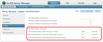

Just an FYI when we ran build after the fix it ran for 2 hours and it failed again.  It was a server time out.  You will just have to verify that on the server side that the time out time is increased from the 7200 seconds default
Once this was updated to about 3 hours it succeeded after 2hr and 37min
