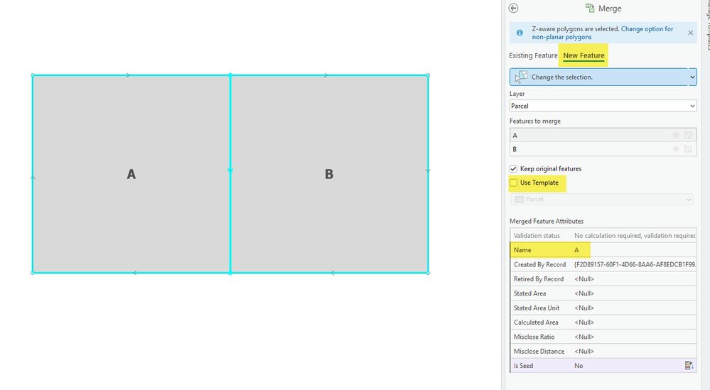

I presume you use this option when you merge (with an active record)
This 'preserves' the attribute of parcel 'A' but retires the original parcels 'A' and 'B'.
Your code will be triggered twice, for the historic A and B.
The issue is the 'order of operations': the parcels are marked historic before the new parcel 'A' is committed to the table. This is the reason you are getting 2 cancelled taxlots instead of the desired outcome of a single canceled parcel 'B'.
We could look into changing this in the tool itself, but the new order of operation might not work for someone else (e.g. - making sure there are not 2 parcels with the same name).
The only solution I can think about is to add another rule that is triggered on insert of a new parcel. If the new the new parcel name exists in the historic parcels, delete it from the cancelled parcel name table.

@DeanAnderson2
