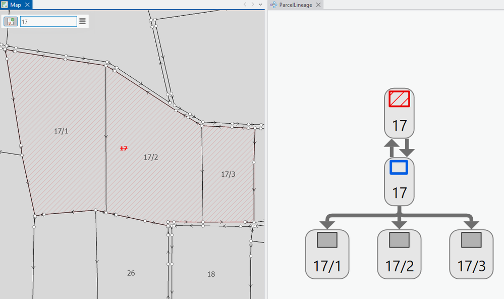

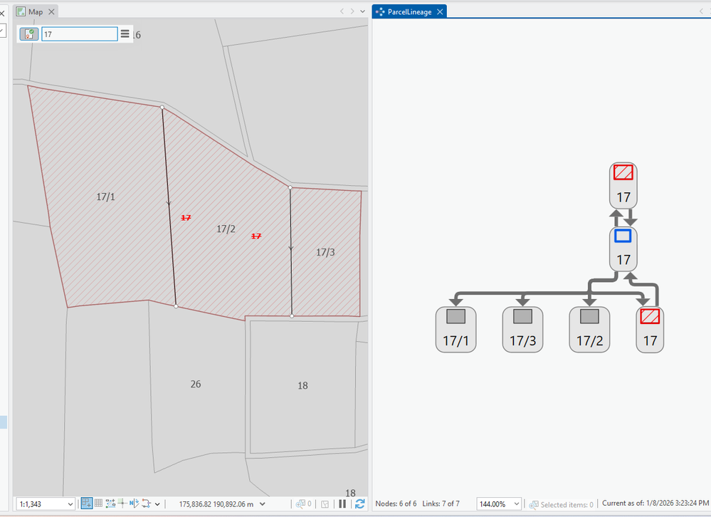

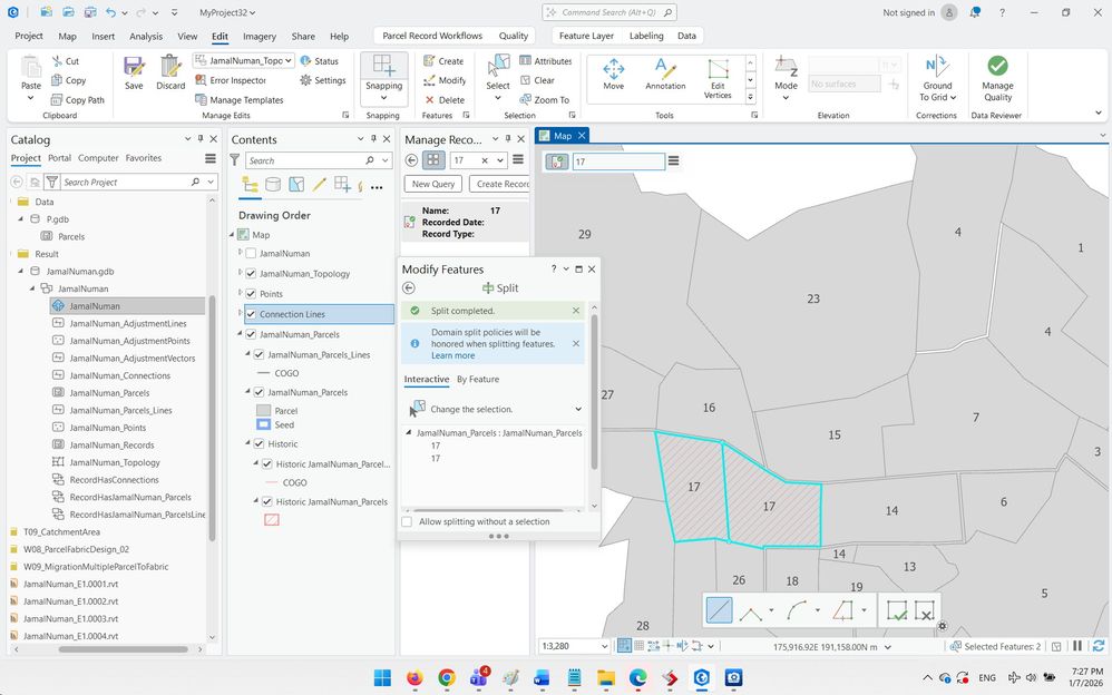

In the screenshot below, parcel #17 needs to be divided into three parcels. Because the split is performed twice, the history of the three resulting parcels is not the same. The resulting parcels 17/1, 17/2, and 17/3 should all have only parcel number 17 in their history; however, this is not the case.
How can this be managed?

The parcel lineage shows the issue. You use record '17' and split the historic parcel twice using the split tool.
The issue is with the worklow.
