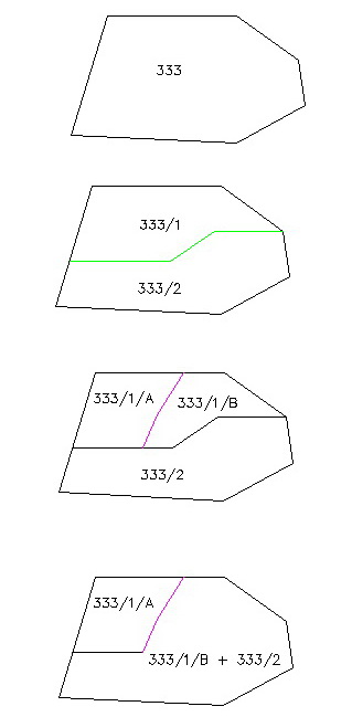

In the screenshots below, parcel # 333 has the following transactions:
- It is split into two parcels: 333/1 and 333/2
- The 333/1 is then split into two parcels: 333/1/A and 333/1/B
- The 333/1/B is merged with 333/2 to form 333/1/B + 333/2
Then what identifying the 333/1/B + 333/2 should display?

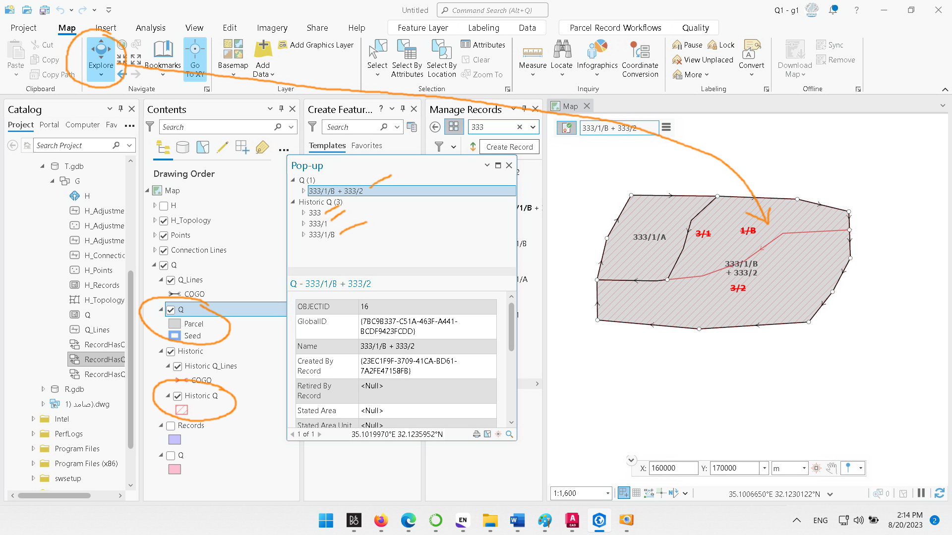

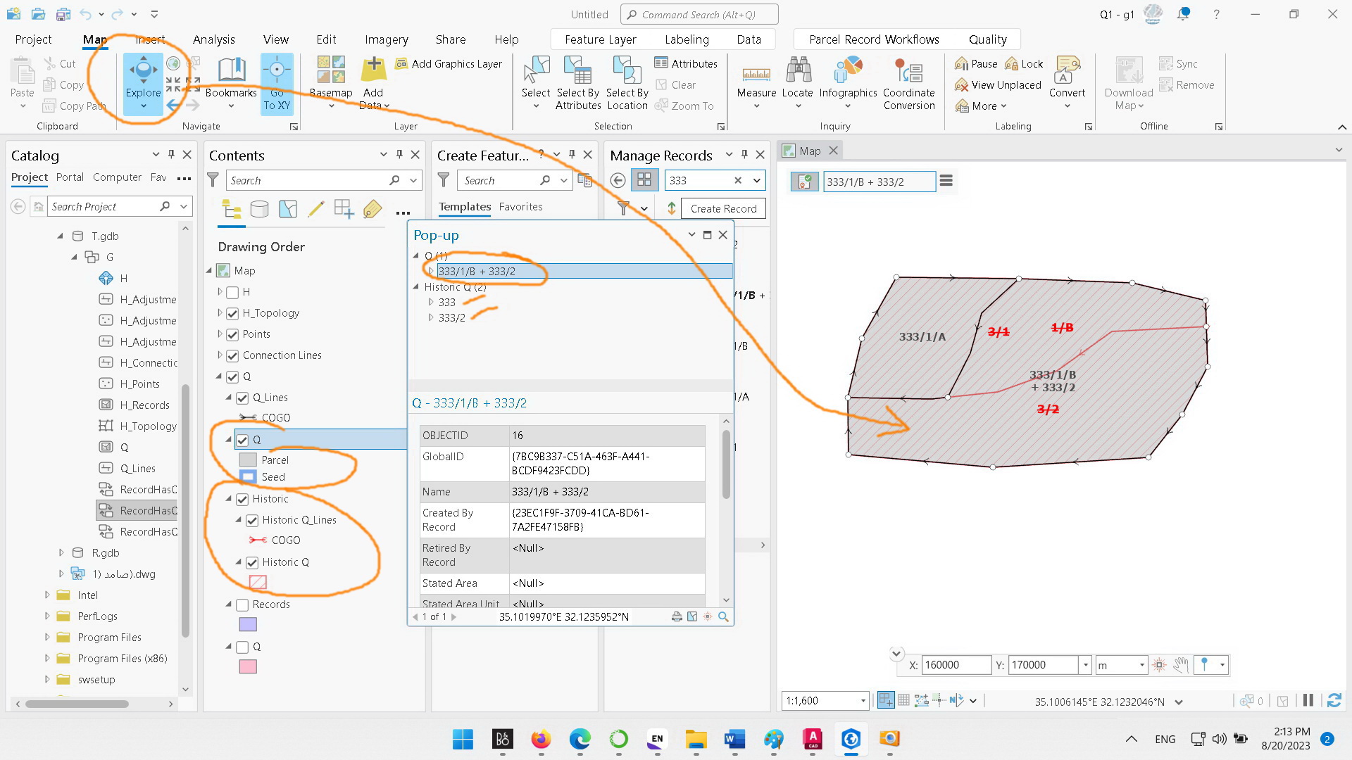

Do we need to turn on the “historic” layer so that the identify can display the history of the 333/1/B + 333/2? Or this could be managed by identifying only the Q layer?
