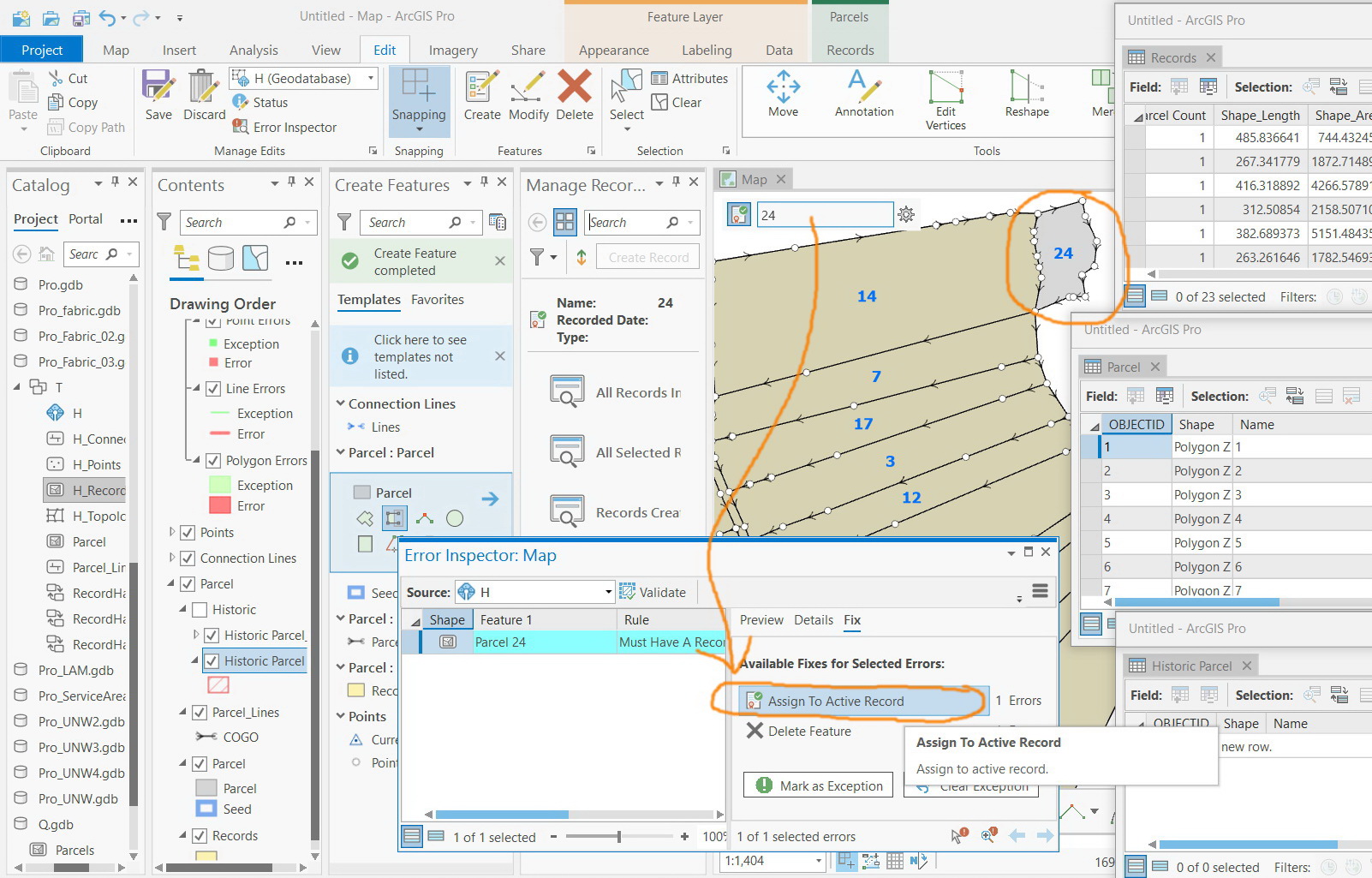

JamalNUMAN
Legendary Contributor

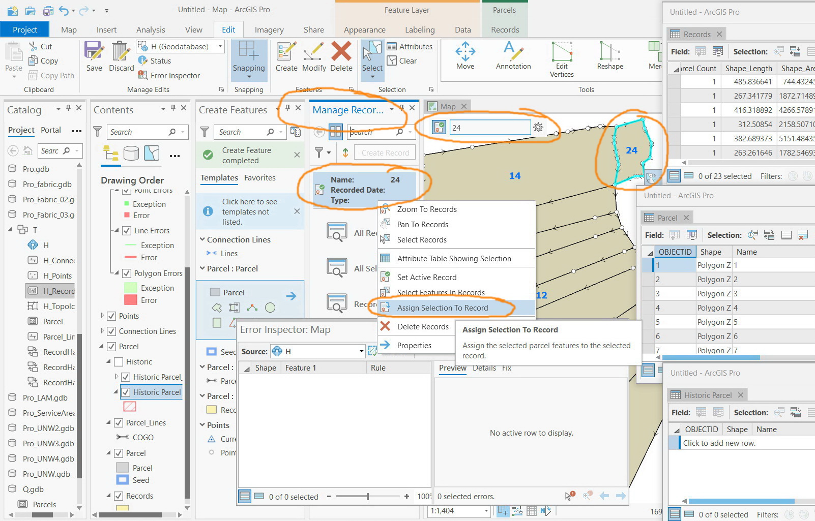

Thanks Dan. Right, I need to assign the new added parcels to a record either with the command “assign to active record” within the topology window or with the “assign selection to record” command in the “manage record” pane.

IrvanSalim
Hi Jamal NUMAN‌,
As you may have figured out, when fixing features with "Must Have A Record" errors, you need to make sure that you have a record that is currently active if you wish to fix it by the "Assign To Active Record" option, otherwise it will be greyed out. You can, however, fix them by assigning the selected parcels to a record through the Manage Records pane (even if there is no active record at the time).
