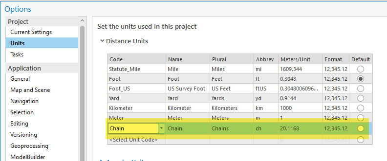

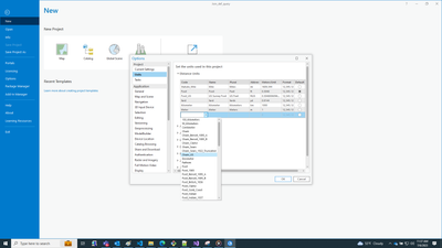

I was just getting on here to post what @JonathanNeal has already posted. Project -> Options >- Units -> Distance Units -> Then click on select unit code and add Chain_US, then you can use the ch override in the traverse tool.
PatrickAllen3
Thank you !!  Got it
AmirBar-Maor
How to add other linear units such as Chains?
Project -> Options >- Units -> Distance Units -> Then click on select unit code and add your favorite Chain flavor.
You can also get rid of units that are not applicable
Open the traverse pane and you will see the units
