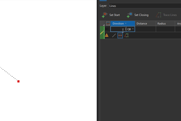

Hi jcarlson, what you describe sounds identical to a bug that was fixed for 2.5. (Esri internal reference: 1486)  Are you working on Pro 2.5 or higher?
If so, I'm not sure what might cause this bug to reappear. Here's a video showing use of the "+" and "-" in 2.9:

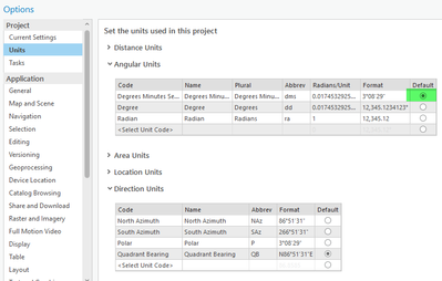

And just to confirm you're looking in the right place for the Angular Unit settings in the project backstage:

@jcarlson- thanks for your post. Based on our screen-share this morning, the issues you’ve helped us to uncover are as follows:
1. The default angular unit is in Degrees for new projects. A project template would help with this. You could create a project template that has this setting pre-defined to be Degrees Minutes Seconds. There are few other benefits to using a project template. See the help topic here: https://pro.arcgis.com/en/pro-app/latest/help/projects/create-your-own-project-template.htm
2. When the traverse pane is open, and you go to the backstage to change a distance, direction or angular unit setting, the new unit settings don’t take effect immediately in the already-open traverse pane. You have to close the traverse pane and start a new one to see the unit changes. We'll explore some approaches to improve on this experience for future releases.
