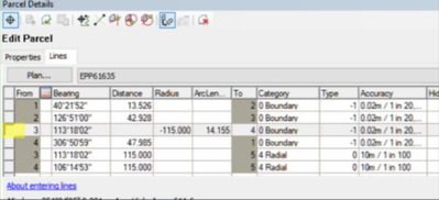

Our use case for this is: we had a parcel with a high misclosure and we couldn't figure out why. It turned out to be due to a bad curve bearing, but this was very hard to identify, since the plan displayed radial bearings and the lines in the fabric displayed chord bearings. In ArcMap, we would have opened the parcel, which would have showed us the radial bearing since those would have been the properties stored on the plan. Then we could easily compare what was entered to the plan. We would find it helpful to have something that allowed us to do this in ArcGIS Pro.
that radial line in shown in desktop
needs to be this according to plan
but you only get the chord in ArcGIS pro so I have no way to enter a new radial

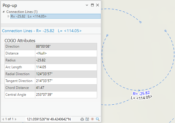

@SeanLyons- a pop-up is a good option for this. You can configure the popup for the line layer to calculate the Radial direction (and other curve parameters) from the existing circular arc COGO attributes, and then present those in the pop-up list. Like this:
Radial Direction Arcade Expression:
function DMS_North(azimuth){
    return ConvertDirection(azimuth, {directionType:'North', angleType: 'Degrees'}, {directionType:'North', angleType: 'DMS', outputType: 'text', format: 'd[°]mm[\']ss["]'})
var radius = $feature.Radius
var arcLength = $feature.Arclength
var chordDirection = $feature.Direction
if( IsEmpty(radius) || IsEmpty(arcLength))
 return
var delta = arcLength / radius;
var chordDistance = 2.0 * abs(radius) * Sin(abs(delta) / 2.0)
if ( IsEmpty(chordDirection) )
return
var isCCW = radius < 0.0
var isMajor = delta > PI * 2.0
var tangentDirection = chordDirection - (delta/2.0*180.0/PI)
var radialDirection
iif(isCCW, radialDirection = tangentDirection - 90.0, radialDirection = tangentDirection + 90.0)
return DMS_North(radialDirection)
Tangent Direction Arcade Expression:
 return
return
return DMS_North(tangentDirection)
Chord Distance Arcade Expression:
 return
return Round(chordDistance,3)
Central Angle Arcade Expression:
function RadiansToDMS(input_radians){
    return ConvertDirection(input_radians, {directionType:'North', angleType: 'Radians'}, {directionType:'North', angleType: 'DMS', outputType: 'text', format: 'd[°]mm[\']ss["]'})
 return
var delta = arcLength / abs(radius)
return RadiansToDMS(delta)

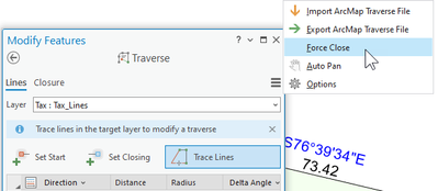

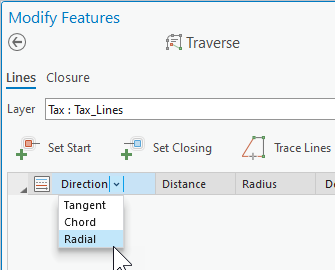

The other thing to consider as a workaround is to use the Traverse's "Trace Lines" tool. Set the traverse tool's Direction parameter to Radial, if you haven't already, and then save the project to make sure this setting is persisted with the map.
Trace over the circular arc line, and change the Radial direction to the corrected value. The geometry of the line will change.
If the preference is to prevent the geometry change, then you can use the "Set Closing" button and click the other end of the circular arc. If needed, use the "Force Close" on the traverse tool settings under the burger button. This would be needed if the change in bearing results in the new end if the circular arc moving beyond the specified closure tolerance (the default closure tolerance is 0.3meters).

Hi @SarahSibbett - using the "Trace Lines" tool actually does modify the existing lines, and does not create new ones. The trace takes the existing COGO stored on the lines into the traverse grid so that you can fix/re-enter the values for that same set of lines. In this example it's a "one-course" traverse, but if you want to re-check the closure for the original entered values (usually in a closed loop), then you'd trace over the whole loop. After you type in the new COGO values the geometry will update, to adjust the traverse based on the type of closure chosen. For the "one-course-traverse" workaround, that one existing line would have its geometry updated, unless you've set the close point, force close setting, etcetera, as described above.
