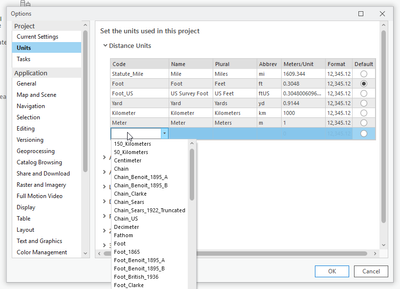

AmyAndis
You will need to add chains to your list of Distance units in the Project options, then you will be able to use the "ch" override in the Traverse tool.
jcarlson
@AmyAndis  thank you! That's really great to know!
Might have helped if I read the "tip" box at the bottom of the documentation page, but it's been a while since I actually visited that page. I only tried "ch" and saw it didn't work, but didn't realize it was an application setting that would enable it.
