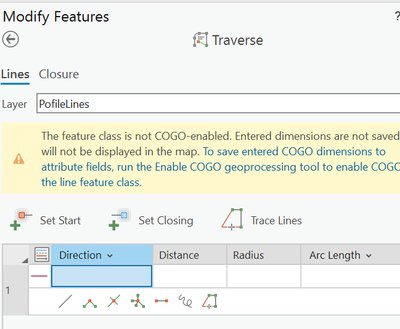

When using the Traverse tool, the traverse is drawn as separate lines for each set of dimensions that are inputted, rather than a single polyline. In ArcMap, traverses were created as polylines by default. This would be helpful as I am using these traverses to split parcel features for subdivisions and other parcel edits. Currently, I have to merge the traverse lines together after inputting all of the dimensions.

If you click on the first icon below the direction box (the one without red dots on the line) it will create a polyline instead of a two point line.

@Syvertson For some reason, clicking the first icon without the red dots still results in separate line features rather than a single polyline. Not sure if this is intended or not.

This is something some of our mappers have asked for. Traverse should have the option to do this where it is visible.
