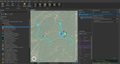

2. The projection for the CAD layer needs to be defined if it is not already. This must be the projection that the transformation parameters are based on, otherwise the CAD Layer will not be correctly placed. To do this select one of the CAD layers in the CAD group layer in the table of contents.TimHodson_1-1636687632054.png
3. The contextual ribbon for the CAD Layer becomes available, and presents the CAD Data tab.
4. Click the Define Projection button and use the GP tool that appears to set the projection for the CAD file.

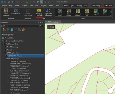

Odd, when I move cad data from catalog to content, the layers aren't selectable, it's all just one big polyline feature class. I regularly convert to GDB then split by attribute layer to get the layers to show up like you have in the screenshot above as well as the demo.
I installed the plugin (for 3.x not 2.x), rebooted the whole system, defined the cad projection then dragged the polygon layer over. Same issue for points and polylines.
Also I'm looking for a way to transform individual CAD features instead of just one feature at a time. Often my CAD data shows different CAD pages as different locations. Optimally I want a way to make these "1-PAVE-ROAD" features lay directly on top of eachother
Am I missing something or is my CAD data just poorly formatted?
RobHastings
Piratecheese, after you add your CAD data to the TOC, click on the CAD Data tab on the ribbon and then click on Group By CAD Layer in the Layer group. This will make your CAD layers selected and editable.
