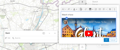

Is there a (simple) way to add a YouTube video into a textfield in a sketch layer?
I just copied the YouTube address
and paste it inside the text field of a sketch layer object
Immediately in the editing mode I see the video

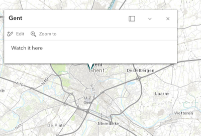

But when I click on OK it is no loner visible in the pop up window in the map viewer
So what am I doing wrong here?

We dont support adding iframes or using that embed html into popups.  When you save the map the sanitizer will remove it.  Check out this thread discussing how you can get videos into the popup.
https://community.esri.com/t5/arcgis-online-questions/new-map-viewer-embed-video-in-popup/m-p/129424...
