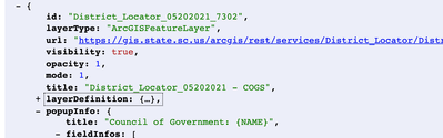

If I look at the web map json it looks like the layer names match those shown in the app. Here's a screen shot showing the title of the layer is District_Locator_05202021 - COGS. If you open your web map in the Map Viewer do you still see your custom layer titles?

Not sure what happened I recreated the app and now it displays everything correctly
