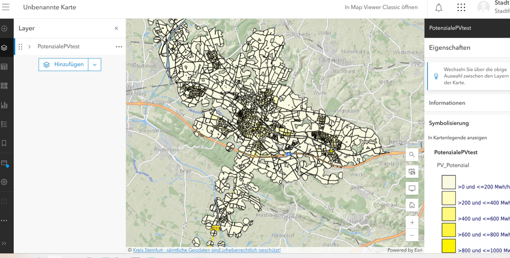

Dear users,
I have created a WMS with (UMN) MapServer, that allows GetFeatureInfo-Requests. I have tested it successfully in some applications.
I can visualize that WMS in a "ArcGIS Online Web Map".
But: Is there a way to do a GetFeatureInfo-Request? It would be nice to get informations after clicking on the WMS in a pop-up. Is this possible?
Thank you very much, Kai
WMS in AGO WebMapWMS in AGO WebMap

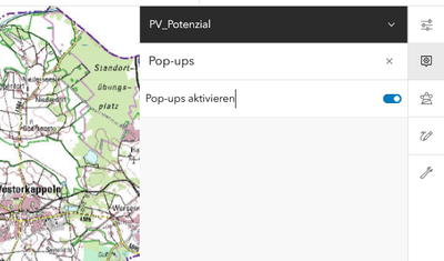

Ok, I found a solution. In the "Web Map" it`s important to select the layer (in Map Viewer) and to activate Pop-ups at the right side:

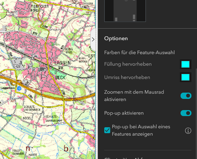

After that, one can implement the "Web Map" in Experience builder and activate pop-ups generally in the map:

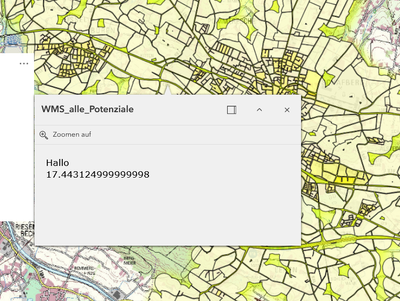

After that after a click one can get "GetFeatureInfo-Results":
