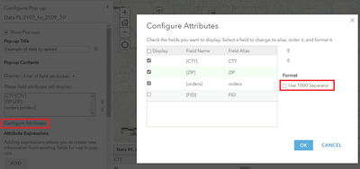

Im trying to upload order data per Zip to ArcGis. I have formatted the Zip as TEXT but I still get the wrong format when its uploaded. As you can see below is there a , in the ZIP which means that it will not match with the Zips in ArcGis that don’t include a ,   . Attached can you see the file I have uploaded for the Printscreen but I have tried different countries, zips, formats but nothing seem to be working and I cant understand why.
Is there anyone that know whats wrong with the file Im trying to upload so that I get these , in the ZIP?

I believe the best thing to do is to Configure Pop-up, > Configure Attibutes and uncheck Use 1000 Separator for the ZIP field.
