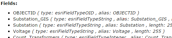

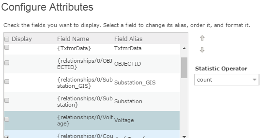

When I configure pop-ups from my related table data in a webmap, I am limited by what I can show. The configuration window allows only one 'Statistic Operator' option for fields which are strings.
A quick snapshot of the Service Directory shows that these are String fields.
How can I show these fields in a pop-up correctly, as strings, and not counts?

Hi Joshua, is your relationship a one-to-many relationship? If so, it's documented that when displaying attributes within the pop-up, string fields show the count. (Configure pop-ups—ArcGIS Online Help | ArcGIS)
