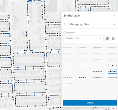

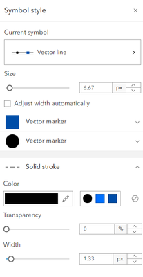

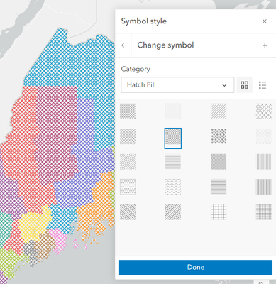

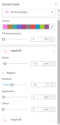

Are you using Map Viewer or Map Viewer Classic?
Map Viewer supports the symbol layers that you see with vector symbols in Pro. This includes dashes on lines, hatch fills and marker fills, controlling animation properties. We also have most of the galleries available in Pro published up + additional cases
https://www.esri.com/arcgis-blog/products/arcgis-online/mapping/symbol-styler-using-complex-symbols-...
RussRoberts_1-1719935338488.pngRussRoberts_2-1719935419060.pngRussRoberts_3-1719935445277.png
You can also publish your own galleries up or use ones hosted in Online outside the standard gallery if you are missing some of the styles you don't see in the default experience.
