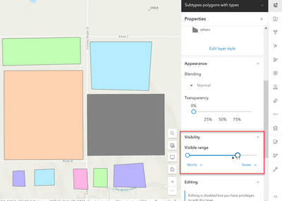

Why can't I see my features when I zoom in, other than the obvious answer?
4 Replies
bbollin
Hi @tfield, is there a visibility/scale range on the layer
