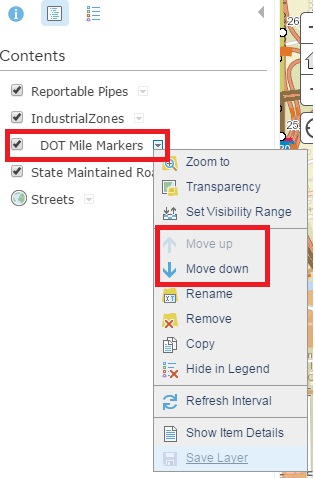

In the screen shot below, notice I am not permitted to move the milemarkers up.  The dragging method doesn't work, either.
When I engage the Industrial Zones, I can't move them down.  And, as you might guess, I want the Industrial Zone polygons UNDER the roads and milemarkers.
I have also tried removing the layers and re-adding them in different order, to no avail.  ArcGIS Online demands I place those polygons above my lines and points.
Any suggestions?  Any known bugs related?

Marianne,
It used to be that if your webmap contained Map Services (MS) as well as Feature Services (FS), the MS could not be moved above the FS. Not sure whether that is still the case, or whether that even applies to your webmap. Just an idea...
Can you post the urls to the 4 layers you are working with?

by Anonymous User
Not applicable
Yup, that was it.  Thanks!
