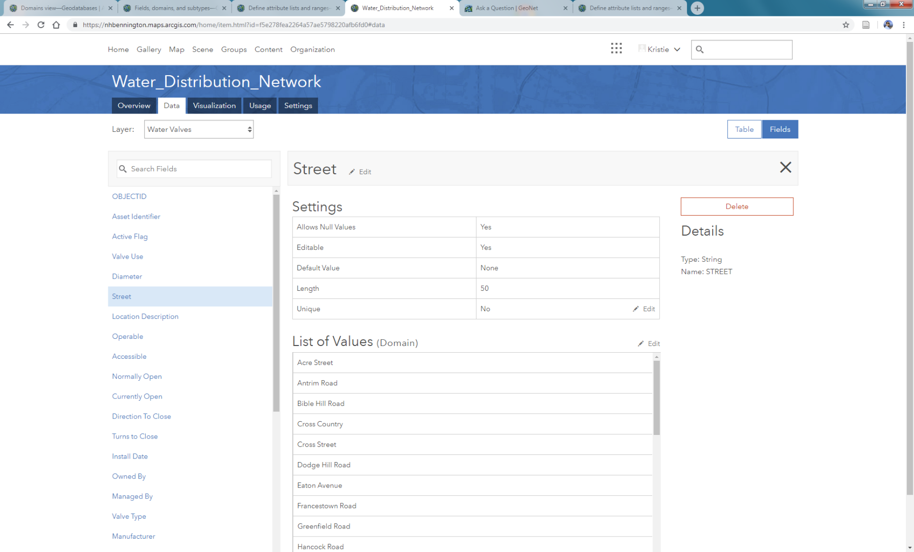

My map and application calls on a number of features that were originally created in ArcGIS Desktop in a geodatabase with coded domains. The migration to ArcGIS Online went smoothly, but I would like to make some adjustments. I understand that this summer, changes to lists are possible: Define attribute lists and ranges—ArcGIS Online Help | ArcGIS.
When I select "Edit" at the "List of Values (Domains)" (pictured in large screen grab below), I am permitted to make changes to to order of items in the list and change the text of items. However, the "Save" button always stays "deactivated." I can only click "Cancel."
Any idea what is going on here?

HenryUnderwood1
Hello Everyone:
I stumbled on the issue. In a specific domain of coded values for a list of street names, there was a duplicate code for one of the entries.
For example, the codes are formatted like this:
Main Street - MS
From data provided by another project partner, I input both "AB" and "RB" as options for the street name "Railroad Bed." The Desktop environment was fine with this but it was not okay with ArcGIS Online.
I simply had to delete one of the duplicate coded values and the domain/list started working as-expected in ArcGIS Online.
