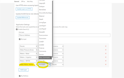

Why am I not given to option to search one of my Feature layers by the OBJECT ID? Im in Web map settings and not given the dropdown option
375
05-13-2025 07:29 AM
AmandaWorzella

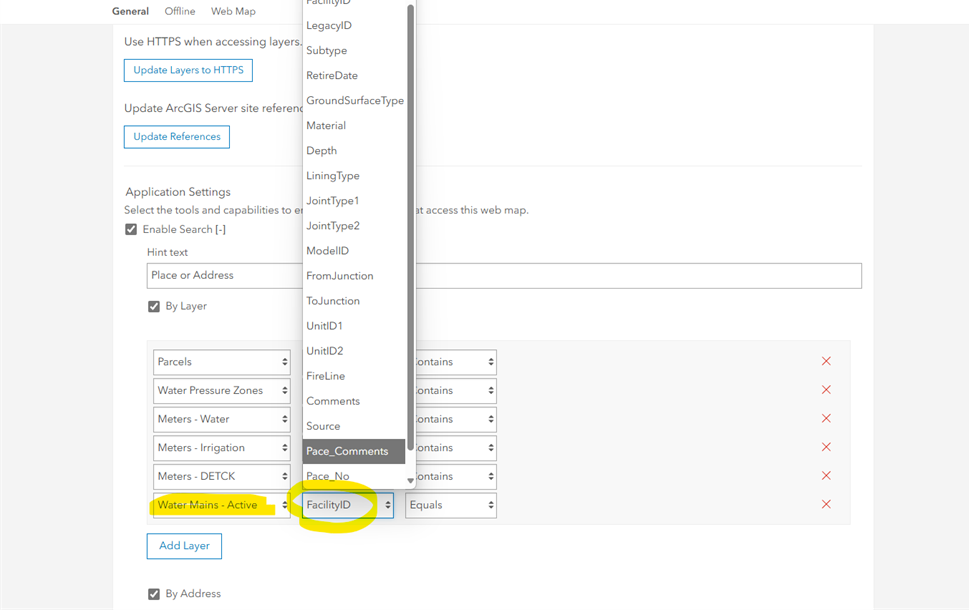

I am using AGOL and trying to add a search by OBJECT ID field on one of my layers. It is not populating in my dropdown options for the fields for that layer. Do I not have the option to search by this identifier? I has a lock symbol next to it on the fields list, does that have anything to do with it? See picture below.
RussRoberts
Esri Notable Contributor
Feature search is based on string and integer fields and currently not on OID based fields or fields using subtypes or domains. https://doc.arcgis.com/en/arcgis-online/create-maps/configure-feature-search.htm
