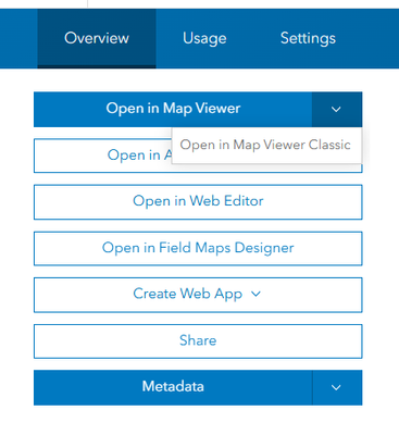

Where is Map View Classic? Is this still available? The button I usually click to work in that view is not showing up. I

You still have the option to open in Map Viewer Classic if you open the web map item and click the down arrow on the "Open in Map Viewer" button.
